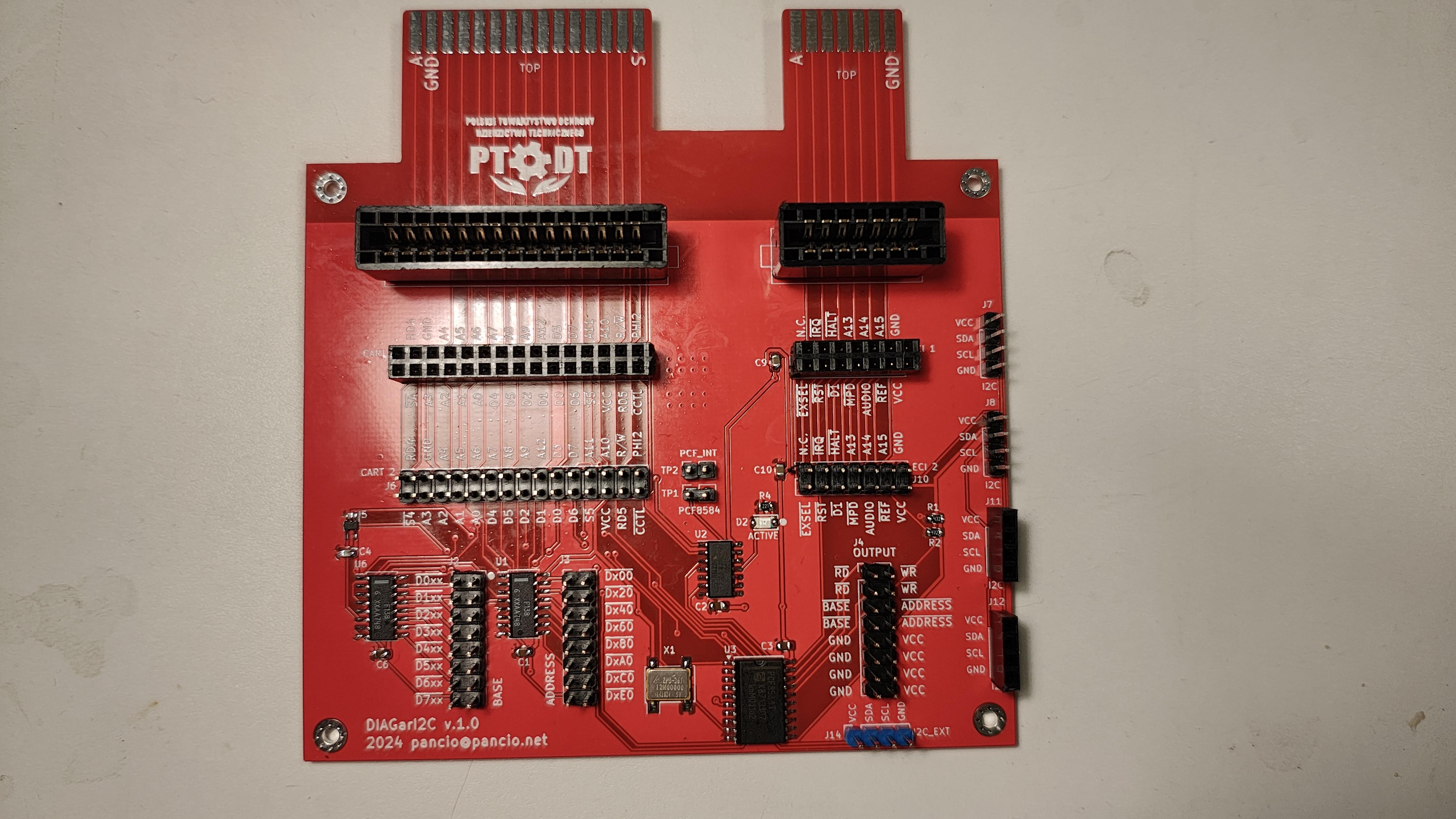

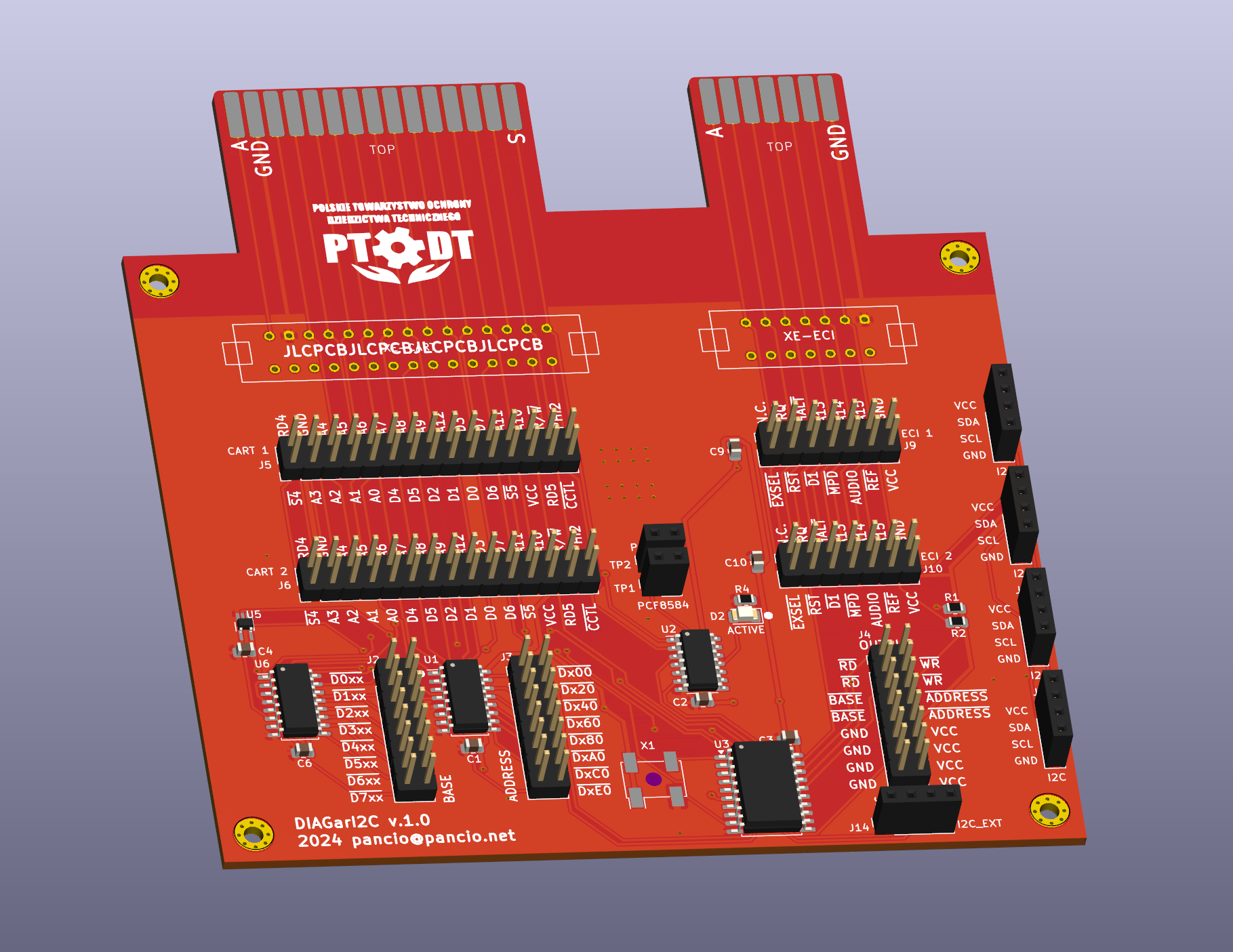

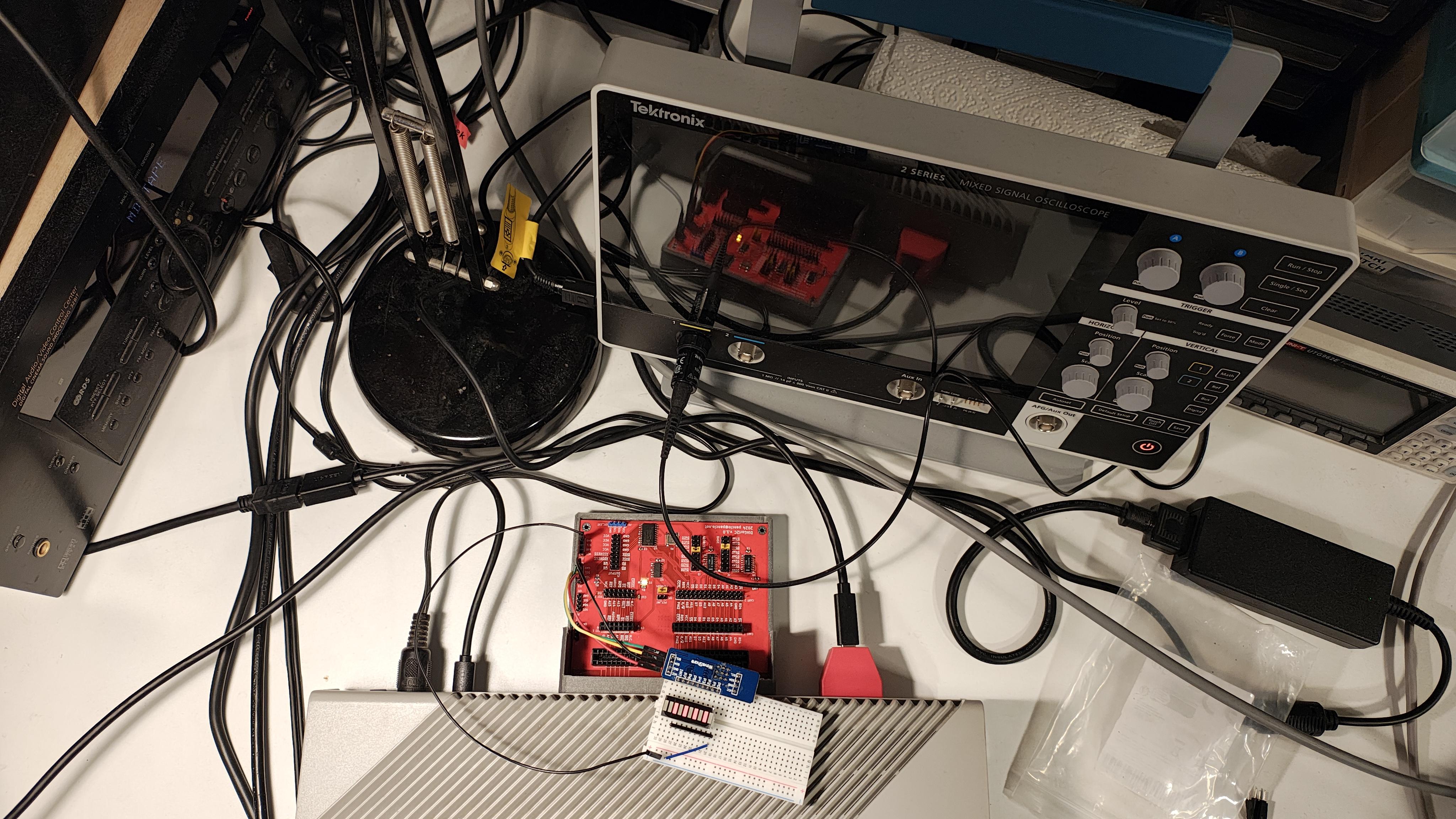

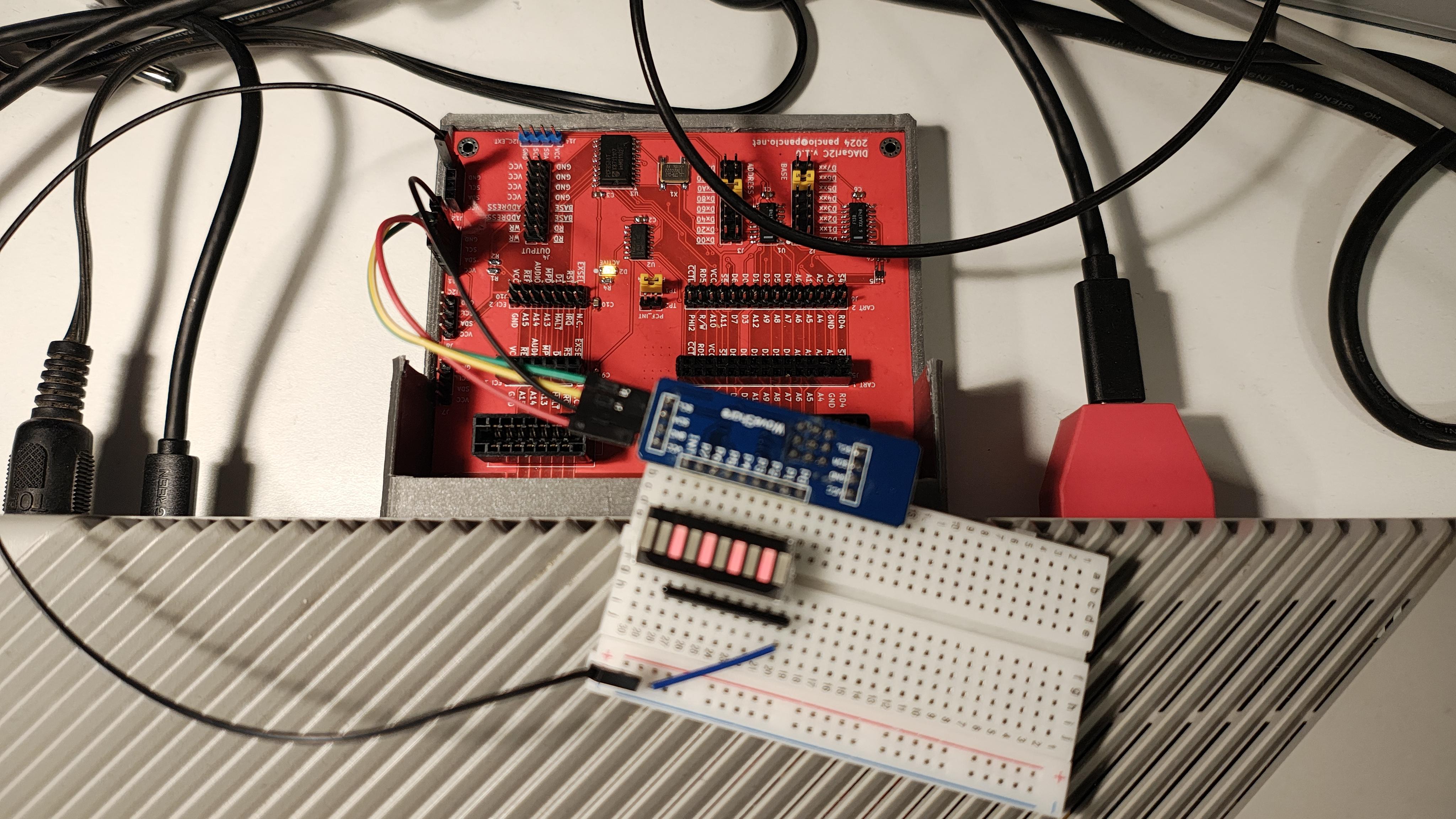

Today I want to introduce my new tool which can communicate Atari with many I2C equipped devices. It's very simply interface contains special IC made by Philips in 90' PCF8584 connected directly to Atari bus. No all features works as expected at this moment but simple communication with e.g. PCF8574A(I/O expander) is possible and we can send and receive data. I wrote short library in MASM to communicate with PCF8584 but it still need some tweaks. Project will be available on my page with a few examples 🙂
I hope, someone will use Atari like Arduino 🙂
If anyone is interested to use/test/develop library I may send PCB :-)
BR, pancio
